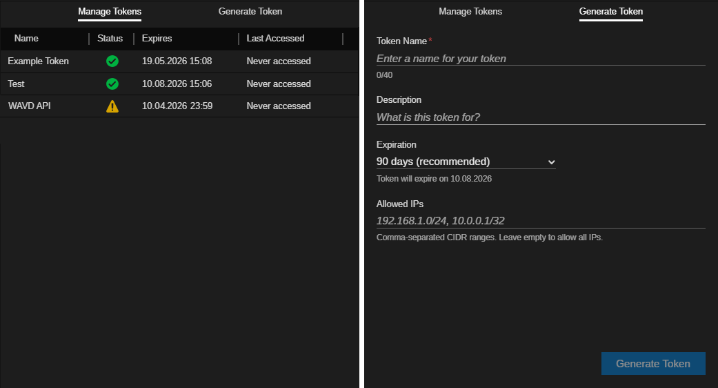

You can use the Personal Access Tokens Settings to self-issue, rotate, and revoke Personal Access Tokens without involvement from either Avid or your local system administrator. The settings are divided into two tabs: Manage and Generate.
If you have not created any PATs, the Manage Tokens tab displays a "No personal access tokens found" message.
Each token is associated with one of the following status icons.

  3. Click the Generate Token tab and enter the following information:
    • Token Name: This name appears in the Name column of the Manage Tokens tab.
    • Description: Enter a friendly description of this token.
    • Expiration: Click the menu to select a default expiration date, or select the Custom option to select a date from the calendar. It is also possible to select the No Expiration option, however this is not recommenced as this option poses a potential security risk.
      The 90 day recommendation is intended to provide a balance between security and usability.
    • Allowed IPs: The IP addresses in this range are allowed to use this token to connect to Avid Content Core. You an do any of the following:
      • Enter one or more CIDR ranges
      • Use a /32 range for a single IP address
      • Leave this value empty to allow access by all IPs
  4. Click Generate Token to save your changes.

  7. (optional) Click the Manage Tokens tab to see your new token.
    The list of tokens is sorted by time of creation, with the most recent token appearing at the top of the list.
