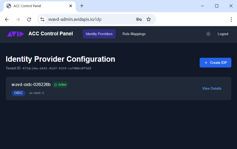

The following example illustration shows the Admin portal with an OIDC configured identity provider.
The portal is divided into two tabs:
Identity Providers. For details, see Configuring an Identity Provider.
Role Mappings. For details, see Reviewing ACC Seats and User Roles.

Click the Admin portal link in the email to open a web browser and access the ACC Control Panel.
At the welcome page, enter the credentials provided in the email.
The temporary access password expires automatically after 7 days of issue. If your password has expired, contact Avid Sales to request a new one.
At your first login, the system asks you to update your password. Enter and confirm a new password and sign in.
The Admin Portal appears.
