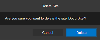

    A Delete Site security prompt opens.
  3. Do one of the following:
    • Click the Delete button to delete the site.
    • Click the Cancel button or press the Esc key to exit the deletion process.
